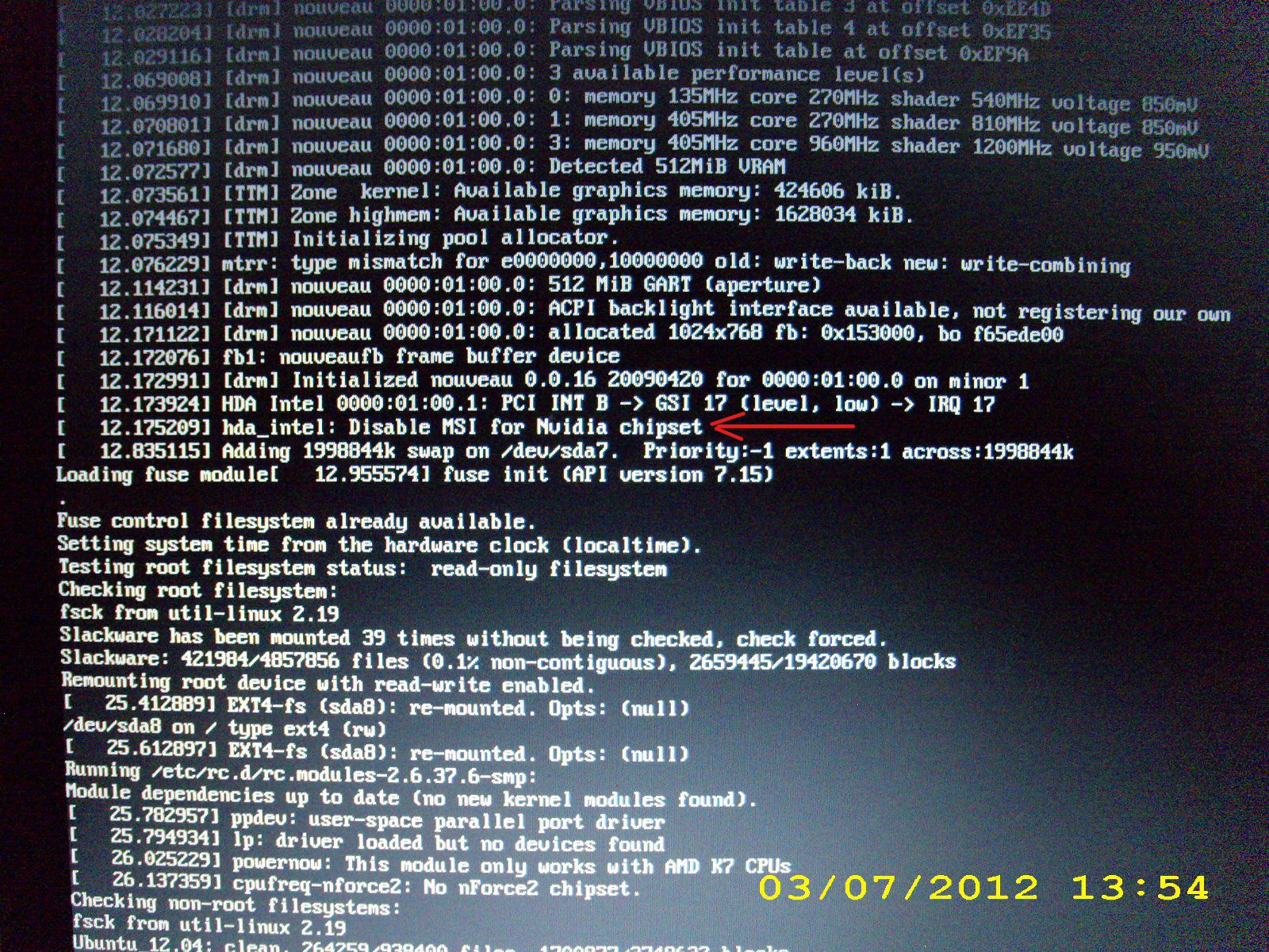

Post Napisano: 01 Jul 2012, 16:25
Izasli su neki SlackBuild-ovi, dal' ovo radi, nije mi poznato
http://www.teoxonline.com/appunti.php?id=25" onclick="window.open(this.href);return false;
Uglavnom dok sam bio na 64bitnom Sleku ovo mi nije davalo nikakve rezultate.
Isto imam nVidia optimus tehnologiju
bash-4.1# lspci -vnn | grep '\''[030[02]\]'
00:02.0 VGA compatible controller [0300]: Intel Corporation 2nd Generation Core Processor Family Integrated Graphics Controller [8086:0116] (rev 09) (prog-if 00 [VGA controller])
01:00.0 VGA compatible controller [0300]: nVidia Corporation Device [10de:0df5] (rev a1) (prog-if 00 [VGA controller])
I sada sve radi na Intelovoj karti koja je u sklopu CPU.
Prilikom butanja desi se kada krene da ucitava nvidia nouveau drajver da ekran skroz pocrni i da da moram opet da ga butam.
Kada uspesno prodje butanje, uspem da vidim da je nVidia na disable i da je Intel u radu (moracu da snimim tok butanja da bih mogao da vidim sta se tacno desava).
Ne znam dal' da probam da blacklist-ujem nouveau nvidia drajver?
To za pocetak, a ozbiljnije cu se baviti sa ovim problemom posto kompajliram kernel na neku noviju verziju sa Bumblebee-SlackBuilds skriptama.
LQ wrote: Nvidia Optimus is not really supported at this time on any level because the hardware relies on a software muxer to control both cards independently which does not exist yet on Linux, using an Nvidia Optimus powered laptop for Linux is actually still ill-advised, but if you wish to brave a non-working or half-working
system, go for it.
You can try BlackListing both the nouveau and i915 drivers to get the Nvidia proprietary driver working. However, the Nvidia proprietary driver is currently the only known module to work with this graphics solution.
Using Kernel 3.1.x is highly advised, as is using the latest libdrm build, and the latest Mesa driver (if you stick to nouveau). Be warned that you will only be able to use one graphics card with this with the other card disabled (the other graphics card will still be powered so you will have a reduced battery life). The i915 driver in most cases will require being blacklisted and you may have to load the nouveau (or nvidia) kernel module at boot time using initrd to have a runlevel 3 sequence.
Mislim da ce valjda i sama nVidia uraditi nesto po ovom pitanju, cujem da ima dosta prituzbi, jer Bumblebee skrip nije garant da ce nVidia optimus raditi, u najboljem slucaju moze raditi samo jedna karta a druga (Inetlova) se mora iskljuciti sto ide na ustrb autonomije baterije.
Posteno, nisam ni znao za ovo kada sam kupovao laptop.
Post Napisano: 03 Jul 2012, 14:01
Evo uslikano kako Intel stavlja Nvidiu na disable prilikom butanja
