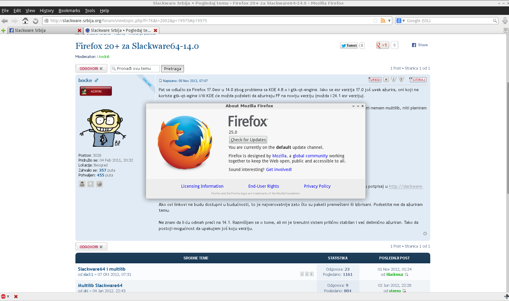

Evo i gotovog paketa Forefox 25.0.1 za 14.0 32-bit
Preuzimanje gotovog paketa:
http://www.brok-linux-lab.org/slackware ... ox-25.0.1/" onclick="window.open(this.href);return false;
SBo http://www.brok-linux-lab.org/slackware ... 5.0.1/src/" onclick="window.open(this.href);return false;
Prikaz verzije:
Prikaz verzije:
